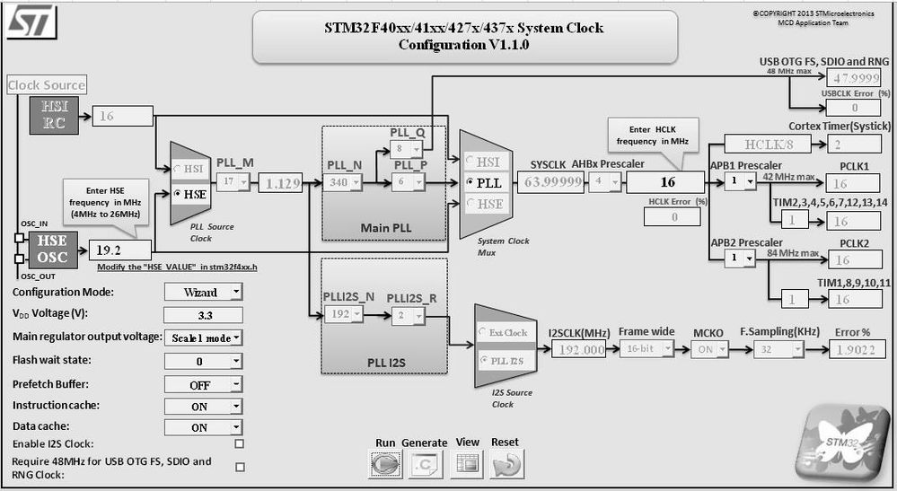

The part is not rated to run at 192 MHz!?
For the baud rate it suggests the define for HSE_VALUE is wrong, ie 8000000 and not 192000002014-09-11 7:32 AM
How did the 192MHz number come up?
I've included a screen shot of the clock config tool.Shouldn't the HSE_VALUE match the actual oscillator frequency or you are saying that the UART library only expects a 8MHz external OSC?We’re moving the ST Community to a new platform to give you a better and more reliable community experience.
