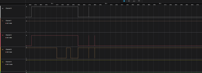

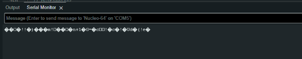

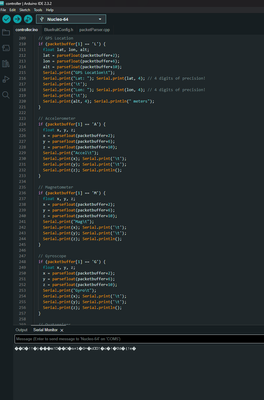

When I use my arduino and the demo code it works perfectly but when I connect to my stm32 and do my code based on the demo code I have a problem during the factory reset, the module shuts down and I can't see the ble module on my phone.
I have checked my wires 3 times and also the power supply provided by the nucleo I have the 3.3V
I use doclight to monitor uart communication for debugging

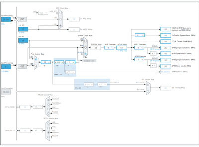

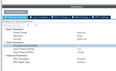

Thanks for the link, I managed to get past the hardfault which was an IRQ configuration error.
I tried the STMDuino, to download the arduino code and debug and find out why I still can't communicate with the module. I discovered that there was a problem with the SPI clock speed as shown in the screenshot.
So I've changed the SPI clock (presacaler for Baud Rate) so that it's closer to 4Mhz like the arduino, but I still don't have any communication. Should I change the clock for the whole system?
Best regards.

@Paulo971 wrote:I discovered that there was a problem with the SPI clock speed as shown in the screenshot.
You mean this:
That more likely shows a baud rate error on the UART link between your target and the host system.
Or are you sending raw binary to the Serial Monitor? It needs to be printable text.

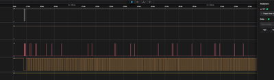

Hello @Andrew Neil,
I get my self a code analizer and i dont understand why the clock on the STM32 stop after the first message send compare to the arduino code
The logique signal from Nucleo SPI
the logique signmal from arduino spi
2025-01-24 8:24 AM - edited 2025-01-24 8:28 AM
@Paulo971 wrote:i dont understand why the clock on the STM32 stop after the first message
According to your screenshot, it isn't even starting properly!
The clock should run continuously for each byte transferred.
Are you sure you have that wired-up correctly?
Have you also looked with an oscilloscope to verify that there's no "analogue" problems?
What Arduino did you use?
PS:
What do you see (on both STM32 & Arduino) if you disconnect BLE module completely.
Of course, you won't get any response like that - but you should see at least the start of the transmission ...
