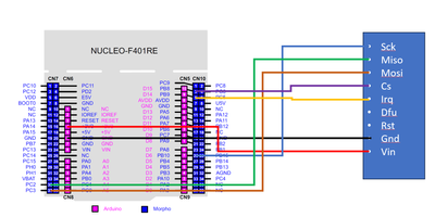

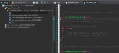

When I use my arduino and the demo code it works perfectly but when I connect to my stm32 and do my code based on the demo code I have a problem during the factory reset, the module shuts down and I can't see the ble module on my phone.
I have checked my wires 3 times and also the power supply provided by the nucleo I have the 3.3V

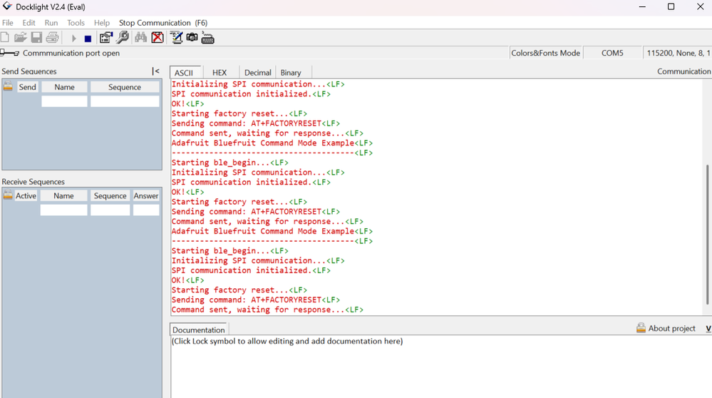

I use doclight to monitor uart communication for debugging

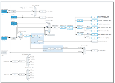

void SystemClock_Config(void)
__HAL_RCC_PWR_CLK_ENABLE();
__HAL_PWR_VOLTAGESCALING_CONFIG(PWR_REGULATOR_VOLTAGE_SCALE2);
RCC_OscInitStruct.OscillatorType = RCC_OSCILLATORTYPE_HSI;
RCC_OscInitStruct.HSIState = RCC_HSI_ON;
RCC_OscInitStruct.PLL.PLLSource = RCC_PLLSOURCE_HSI;
RCC_OscInitStruct.PLL.PLLM = 16;
RCC_OscInitStruct.PLL.PLLN = 100;
RCC_OscInitStruct.PLL.PLLP = RCC_PLLP_DIV2;
RCC_OscInitStruct.PLL.PLLQ = 7;
Error_Handler();
RCC_ClkInitStruct.APB1CLKDivider = RCC_HCLK_DIV2;
RCC_ClkInitStruct.APB2CLKDivider = RCC_HCLK_DIV1;
if (HAL_RCC_ClockConfig(&RCC_ClkInitStruct, FLASH_LATENCY_1) != HAL_OK)
Error_Handler();

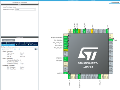

static void MX_SPI2_Init(void)
/* USER CODE BEGIN SPI2_Init 0 */
/* USER CODE END SPI2_Init 0 */
/* USER CODE BEGIN SPI2_Init 1 */
/* USER CODE END SPI2_Init 1 */
/* SPI2 parameter configuration*/
hspi2.Instance = SPI2;
hspi2.Init.Mode = SPI_MODE_MASTER;
hspi2.Init.Direction = SPI_DIRECTION_2LINES;
hspi2.Init.DataSize = SPI_DATASIZE_8BIT;
hspi2.Init.CLKPolarity = SPI_POLARITY_LOW;
hspi2.Init.CLKPhase = SPI_PHASE_1EDGE;
hspi2.Init.NSS = SPI_NSS_SOFT;
hspi2.Init.BaudRatePrescaler = SPI_BAUDRATEPRESCALER_2;
hspi2.Init.FirstBit = SPI_FIRSTBIT_MSB;
hspi2.Init.TIMode = SPI_TIMODE_DISABLE;
hspi2.Init.CRCCalculation = SPI_CRCCALCULATION_DISABLE;
hspi2.Init.CRCPolynomial = 10;
if (HAL_SPI_Init(&hspi2) != HAL_OK)
Error_Handler();
/* USER CODE BEGIN SPI2_Init 2 */
/* USER CODE END SPI2_Init 2 */

Hey @Andrew Neil
I'm using the STM32F401RE. Below are some images of the configuration and connection.
Unfortunately, I don't have an oscilloscope or a logic analyser.
I want to use SPI to learn how to communicate with SPI and also because it's faster than UART communication.
Best regard.

2024-12-17 8:06 AM - edited 2024-12-17 9:10 AM
@Andrew Neil I've made the change in my code but I'm still stuck with the same ‘ Command sent, waiting for response...’ message.

@Andrew Neil when i try to debug i stop at Hardfault_Handler that return to function sendCommand inside the while ((HAL_GetTick() - startTick) < timeout)

@Paulo971 wrote:when i try to debug i stop at Hardfault_Handler ...
So your code is crashing - with a Hard Fault.
On debugging Hard Faults - both Cortex-M in general, and STM32 in particular:
@Paulo971 wrote:... that return to function sendCommand inside the while
The Hard Fault handler wouldn't usually return at all ?
2024-12-17 9:40 AM
@Andrew Neil i mean when im in the debug its stop at the hardfault function and the IDE show me that on the left
