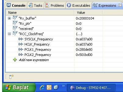

however the RCC_ClockFreq gives the correct values as you can see at the attached picture
above --> 168 MHZ , 42 MHz and 84 MHz
if I declare the HSE_VALUE as 12 MHz the clock values changes ( not 168 Mhz anymore )

The RCC_ClockFreq structure is a pure computation exercise, not a physical measurement.
You need to set the compilers command line to have the define -DHSE_VALUE=12000000 this may be a compiler related project setting, or done more explicitly. The you will need to go into system_stm32f4xx.c and modify one or more of the PLL_x values. For integer HSE values, probably just PLL_M#define PLL_M 12 // Divide HSE to get 1 MHz comparison frequency
