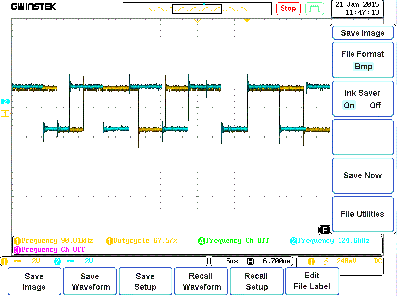

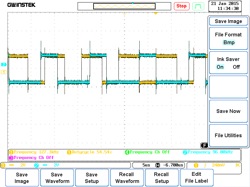

I have just taken some retests, disabling the complementary output. And I found out that the frequency difference also occurs between two active PWM output Channel 1 (PA8) and Channel 3 (PA10).
It occurs both between two complementary outputs and between two outputs of two channels2015-01-20 9:50 PM

Sorry.
I'm using Kit STM32F407VG Discovery to control frequency of FullBridge LLC Converter. I use 50kHz Interrupt TIM2 and CH1,1N,3,3N PWM TIM1. The PWM frequency band is 80-140kHz.When updating new frequency (TIM1->ARR), the frequency of 4 PWM outputs is randomly not the same, shortcircuiting my converter.
I have no idea to do next. Please help me!!We’re moving the ST Community to a new platform to give you a better and more reliable community experience.
