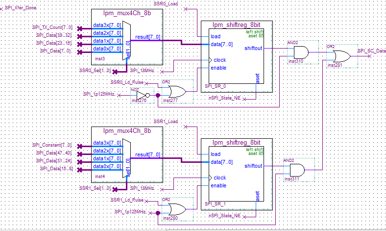

I have an Altera FPGA tied to a F429 and shift the data in and out via a 16bit bus but
that was tricky making a whole 16 bit port free even on a 176 pin device.
Using the FSMC sounds like a good idea so long as you your not using SDRAM as well.
For an alternative, how about using high speed SPI and a double buffered DMA to pipe
the data in from the FPGA, so it?s always ready when you want to read it.

OK, if you need random access to the data in the FPGA then the FSMC interface looks like the best option.
However, if you are accessing the data sequentially (or even discontinuous sequentially) then the extra
pins taken up by the address bus seem a waste of pins to me, unless you have the pins to spare.
In my case I use the the FPGA's connected to cameras and the information I want from them is either the
whole or a block of the image, the resultant data or the JPEG data.
I use a programmable counter within the FPGA to generate the address value and an edge triggered signal to
update it.
The data passed over SPI is status data so I can detect events without having to address and read a register.
Which I think is the optimal solution to my application, but am always happy to consider alternatives :)
