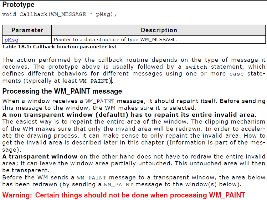

When you make a custom dialog, you must make also a function to paint the dialog
Inside your message callback function you must catch the case 'case WM_PAINT:'
When the GUI needs to paint the dialog(because is invalid by some movement ) gives this message to your dialog message map!!2017-07-28 9:07 AM

Thank you very much, this solved my problem.
