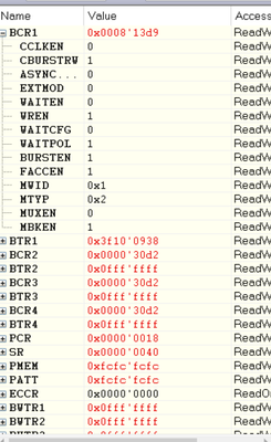

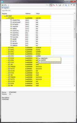

Could you please share a screenshot of the FMC peripheral registers?
2023-11-26 3:43 AM
How do you mean a screen shot? As a capture from within a debug session or a configuration settings view.

2023-11-28 6:12 AM
2023-11-28 6:16 AM
...Another copy, but with BCR1 expanded.
