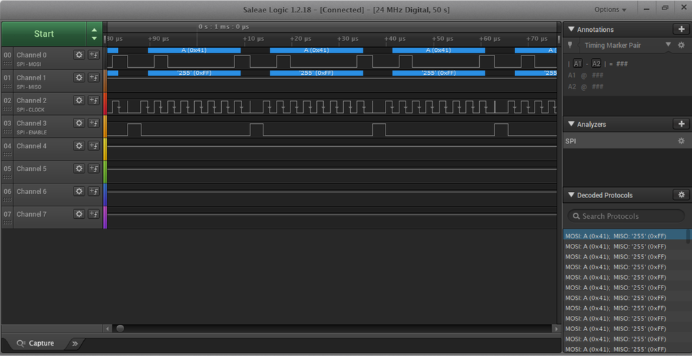

2021-11-18 3:11 AM
Hi TDK,
Thanks for the response.
You were correct about the interrupt,
For testing purpose, I changed to flow and called HAL_SPI_Transmit_DMA from main().
It worked fine for single byte transfer.

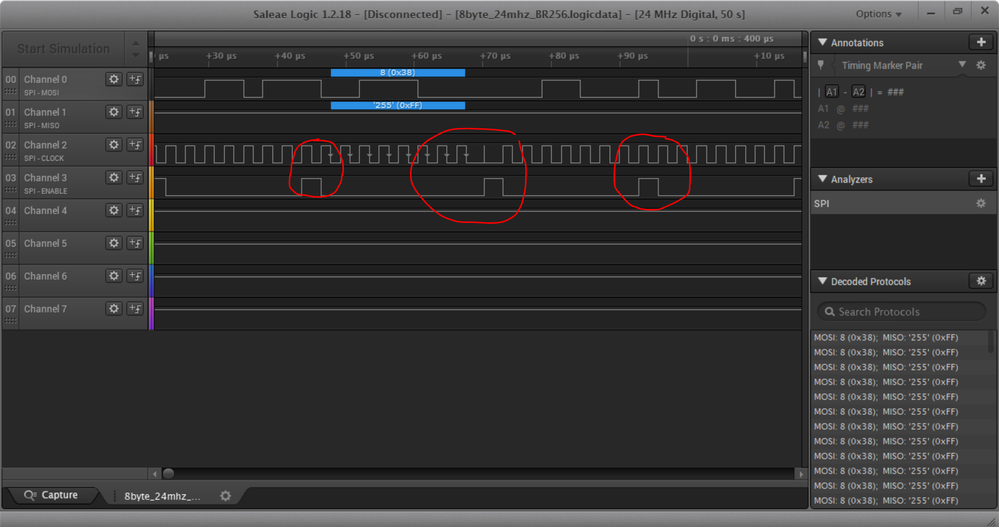

But when I pass multiple bytes( like 8, 25 etc) for last byte in the sequence is getting identified
Please see below, Here data send are "12345678", but only 8 is identified(Data from 1-7 also present in transfer but during the ChipSelect high clock is present)
another example if "ABCDEFGH" is send means H will be identified.
Note: HAL_GPIO_WritePin(SPIx_NSS_Port, SPIx_NSS_Pin, GPIO_PIN_SET); is called inside HAL_SPI_TxCpltCallback() and is fine.

2021-11-18 4:27 AM
> //8u //1u
Was the lower waveform (with red circles) taken with 8u or 1u?
And channel 3 displays the SPIx_NSS_Pin?
2021-11-18 4:34 AM
Hi JW,
Thanks for your response
Lower waveform is taken with 8u.(Correct)
Channel 3 is NSS output.(Correct)
Issue is when the NSS is high, Clock also present. This is what I tried to showcase in image.
