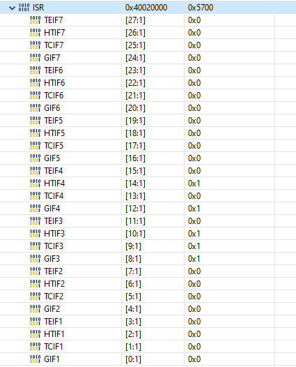

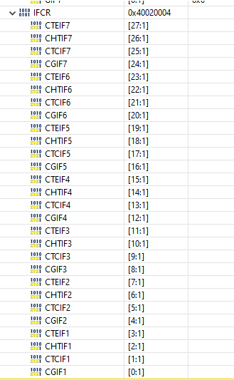

Polled SPI Rx works?
Read out and check/post content of SPI and DMA registers.
2022-11-21 10:41 AM
DMA1 -> ISR register
DMA1 -> IFCR register
DMA1 -> CCR2 Register
DMA1 -> CNDTR2 Register
DMA1 -> CPAR2
DMA1 -> CMAR2
DMA1 -> CCR3
DMA1 -> CNDTR3
DMA1 -> CMAR3

Noticed Behavior:
So in short
2022-11-21 4:08 PM
Discovered the problem: TIM2_UP conflicting with SPI1_RX in DMA Channel 2. Didn't notice the conflict as it extended over to the backside of the printout.
