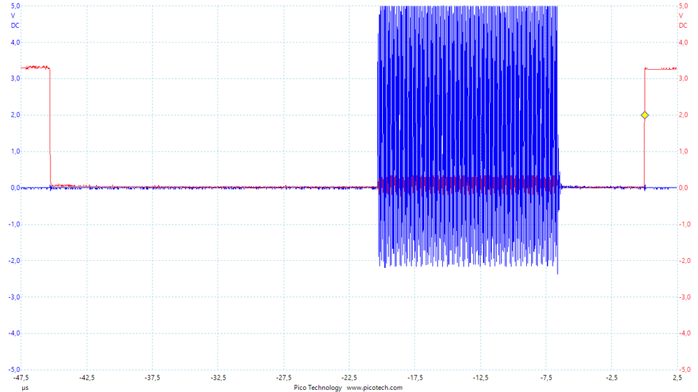

}My problem is, that i often run into the HAL_SPI_Abort case. I used a further pin to see what happens: in blue you can see the CS signal. Before the TransmitReveive function I set the red pin to high, and afterwards to low. Here you can see that the TransmitReceive function runs into a timeout.

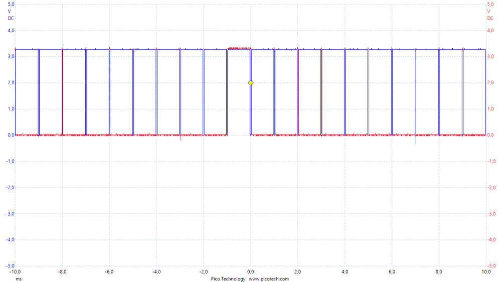

But my problem is, that I don't get any complete packages on the master from the slave, because the last word (containing the checksum is missing/empty), although the time between the last clock and CS going high is (extremely) long:
Maybe I don't see it, but what am I missing here? Why is the last word not transmitted??? Any ideas?
2020-05-19 6:58 PM
Looks like you're giving the slave about 25us to respond to the CS low and put data into the SPI buffer. Maybe this isn't enough time. Are all bytes except the last one correct?

I tried it once again and some more (slightly) modifications, and now it is working - I don’t see any failures on the slave side.
But now I have the problem (maybe also before) that I have sometimes receive problems on the master side, where the MISO signal seems to be false. But running a scope in parallel, I see that the slave transmits the correct data. It isn’t only a bitflip or byteshift, but sometimes complete nonsense. Any idea how this could happen? The master code did not change...
