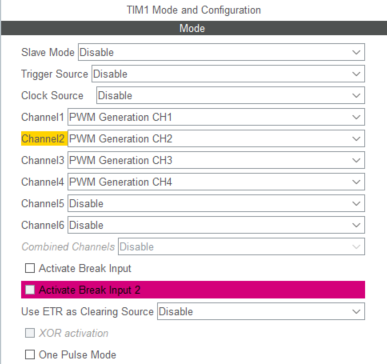

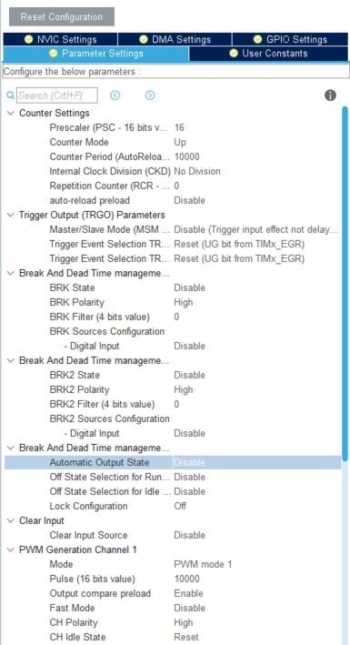

I'm having a problem where I'm controlling 9 LEDs with timers. Whenever I enter stand-by mode, the LEDs turn on/stay on. I want them to turn off. I can shut them down before stand-by mode but as I enter, they turn on. I've tried switching timers into GPIO outputs during runtime and turning LEDs off. That also worked but during stand-by they also turned on. How can i turn them off during stand-by?
Here are some of my timer settings:
2020-05-20 1:15 AM
How do you have connected the LEDs?
How do you have set PWR_PUCRx/PDCRx?
