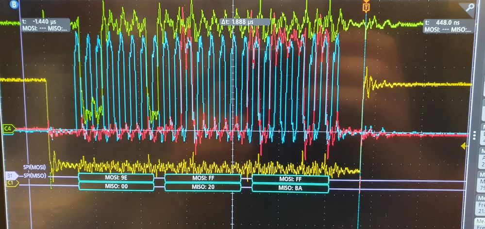

}And I scoped the SPI line. The screenshot shown below.
In scope everything seems to be fine but when I try to read the registers first I read 0x00, 0x20 and when I recall the function again I read 0xBA, 0x00 and if I recall the function again I read 0x20, 0x00. From this point whenever I call the function I read only 0x20,0x00. I am confused

For every byte you send, you need to read a byte, even if you don't care about it, in order to keep the RXNE flag in sync. Your code sends 3 bytes but only reads 2.
