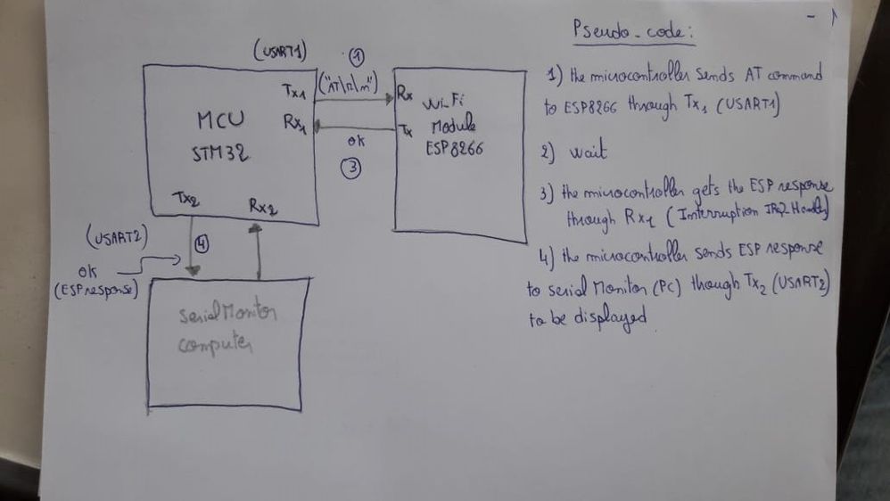

i'm trying to communicate with a Wifi module (esp8266) using STM32F103, on keil IDE. As described in the schematic : i want making my stm32 send AT command to esp8266 through usart1 (Tx1), and getting the esp response (Rx1), then display the esp response on computer serial monitor using usart2 ( Tx2).

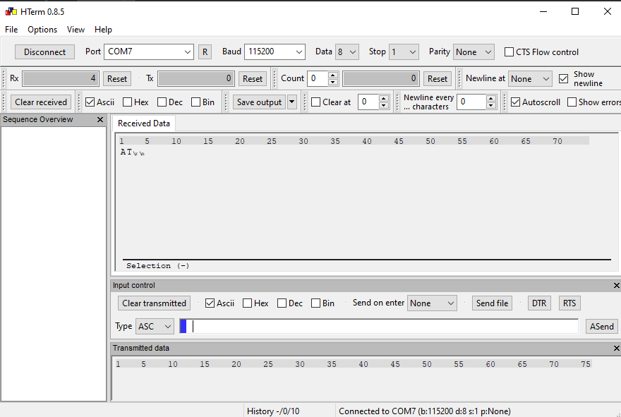

After configuring usart1 and usart2, and writing the functions to send an receive data, i'm getting only the ECHO of the command, rather than the response which should be "OK"

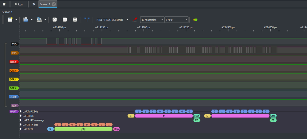

. when i'm sending "AT\r\n", i'm receiving only AT on serial monitor. i will share the code i have wrote, and the traces on logic analyzer. if there is any suggestion i will be thankful.

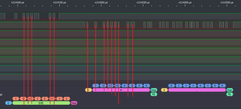

I don't see "AT\r\n\" or "OK" in your logic analyzer plot. I do see that it indicates frame errors on the RX line. Doesn't seem like your baud rate matches what the logic analyzer is set to expect.

You're saying the values match, but your plot suggests otherwise. Possible your HSE_VALUE is incorrect. Put out a known frequency signal such as MCO on a pin and verify the clock is what you think it is.
