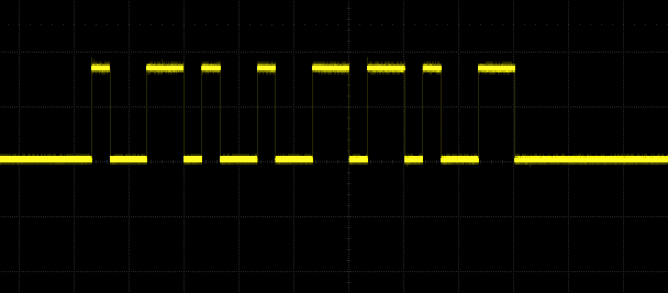

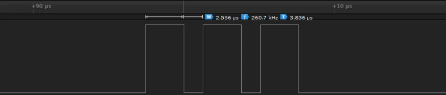

I'm using DMA with TIM1 to drive a string of WS2812B LEDs. I am closely following a tutorial called Controlling Neopixels with STM32 on Digikey (I cannot add links due to the age of my account) with some adjustments, with my ARR being 89, my clock being 72MHz, and my code is adjusted to reflect these changes. All of the LEDs in the chain work correctly, except for the first one. The first one is acting as a "passthrough", where all changes I make to it are sent to the next one in sequence and it remains off. For example, when I change LED[0] to fully red, LED[1] receives that change instead and LED[0] remains off. I can confirm that LED[0] is fully functional, as when I connect an Arduino instead of the STM32 the entire chain works perfectly.
Using a logic analyzer and looking at the signal, I can see that unlike with the Arduino, the STM32 keeps the pin responsible for the timer high after the DMA is finished, most likely causing the first LED in the sequence to think it's getting a signal and causing it to pass through all data it receives. I have tried activating pull-downs in STM32CUBEIDE, setting the PWM to mode 2, changing the PWM polarity, the PWM idle state, writing the GPIO pin low manually, and some other settings that I do not entirely remember. Unfortunately I cannot get the line to stay low after the DMA is finished. I've attached an image of what I am seeing on the logic analyzer vs what is expected (done with Arduino). How can I set the MCU to set this line low when it's finished transmitting?

^STM32 signal, please note how the signal remains high after completion.
^Arduino signal
