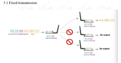

in the documents of datasheet it says : "in fixed mode..."
data[0] is 0x00 which is ADDR High
data[1] is 0x01 which is ADDR Low
data[2] is 0x32 which is Channel (410.125MHz + data[2]*1MHz = 460.125MHz)
so I am sending uint8_t data[5] = {0x00, 0x01, 0x32, 0x03, 0x03}; through to the E220 in tranciever board.

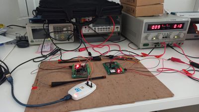

Here is my test station. I got 2 boards with STM32F446VET7 and LoRa E220-400T30S & 2 410-480MHz antenna.

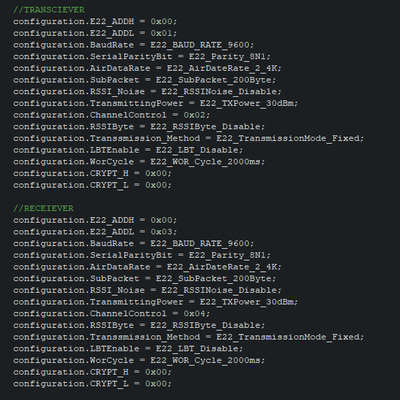

Here is my Transciever and receiever configuration for fixed mode:
and first three byte of data is ADDH(0x00) - ADDL(0x03) - CHANNEL(0x04) of receiever.
uint8_t E220_tx_Buffer[8] = {0x00, 0x03, 0x04, 0x0B, 0x0C, 0x0D, 0x0E, 0x0F};

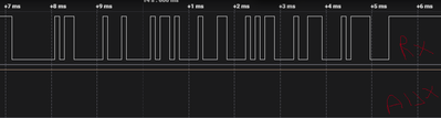

Now my true signals
I do the GPIO SET on M1 and M0 for configuration (deep sleep - configuration mode)
I do the GPIO RESET on M1 and M0 for transmission & receive (normal mode)
ON THE TRANSMITTER SIDE
TRANSMITTER CONFIGURATION SIGNAL :
(WHITE ONE IS TRANSMITTER RX WHICH MCU TX, OTHER ONE IS AUX)

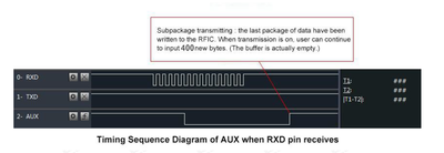

DATASHEET :
TRANSMITTER TRANSMISSION SIGNAL :
(AUX ALWAYS HIGH)

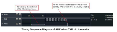

Datasheet :
