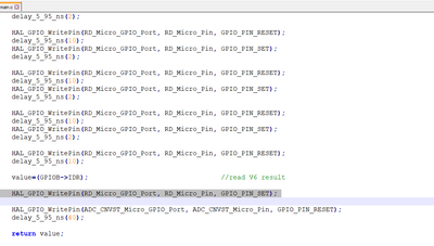

2023-11-04 12:28 AM
in highlighted line we have fault
