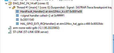

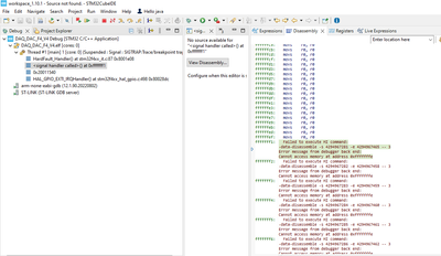

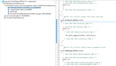

2023-10-23 12:42 AM
this data is displayed on stm32cubeide
what i should with this data?
2023-10-23 1:10 AM
What data?
