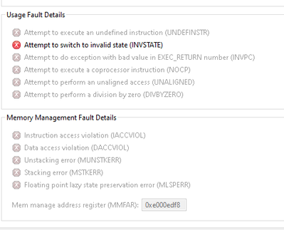

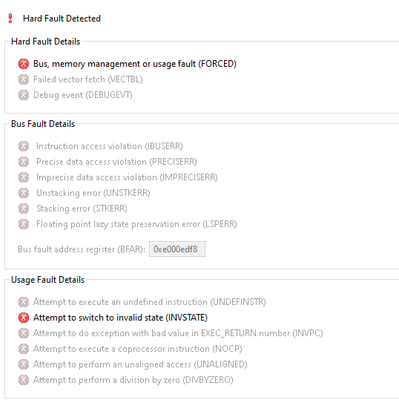

2023-10-25 3:56 AM
most of the time my code faults in EXT Interrupt
but i can not check which section trig this section.
this is the fault analyzer.
2023-10-25 4:33 AM
Frankly your code is not organized properly, you have written everything in one main.c file which is not recommended, you can split into multiple files and enable one feature after other. I can see SPI communication, DAC etc. I recommend you disable all features and use verify only external interrupt code and proceed. Once you fix external interrupt you can add the modules step by step.
2023-10-25 1:11 PM
In the stack trace 20011540 is a RAM address. How you've got there? This looks like stack corruption (overwrite).
