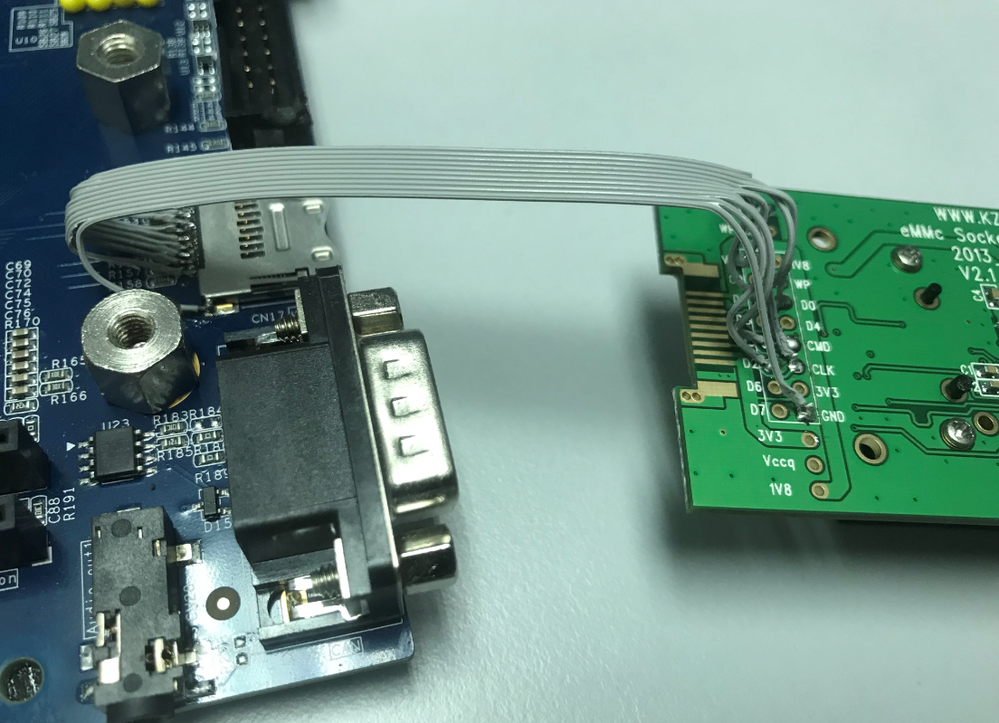

Hi
Turvey.Clive.002
,Actually I'm using STM32F779NI EVK and replace the SD Card interface bus by eMMC.
And this board using SDMMC1
Specifically HSE and debug USART
the HSE and debug USART also effect SDMMC1 pin. But the thing is I alr test with SD Card using SDMMC1 , it working fine.
And you say ST 's code is broken mean their HAL MMC has issues ? we need to do some modification to get it work ?

2018-06-13 2:27 PM
Ok, so this is a blind port to the STM32F779I-EVAL (or F769I-EVAL)
http://www.st.com/en/evaluation-tools/stm32f779i-eval.html
eMMC via SD1 (CN17)
User interaction is implemented via the VCP/RS232 USART1 at 115200 8N1
________________ Attachments : EMMC_F779_DEMO_001.hex.zip : https://st--c.eu10.content.force.com/sfc/dist/version/download/?oid=00Db0000000YtG6&ids=0680X000006HxTD&d=%2Fa%2F0X0000000az1%2FihBvpktkqA8B_qLk98ObV_qjvAQVPJqf_80UjqkOqbg&asPdf=false2018-06-13 10:09 PM
