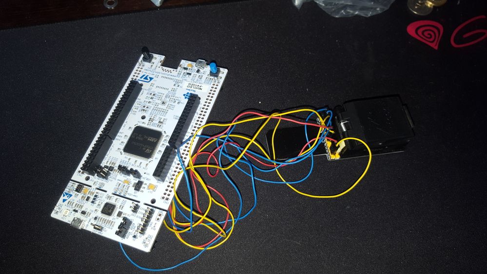

I am using an STM32L452 chip and trying to fully utilize the SanDisk 8GB eMMC memory (
SDINBDG4-8G
). I have found out that the is no eMMC HAL written for the L4 family. Because of that, I tried STM32F412, as it uses SDIO not SDMMC peripheral (the same thing but other name?), and it has HAL written. I have found out however, that as pointed out here
it doesnt work. There are no examples of eMMC usage in STM32Cube_FW_F4_V1.0. From the code it also seems that it only supports memories up to 2 GB. Trying to use the code I was unable to write anything to the momory, like the mentioned topic, even though over a year passed since it was posted.
At the moment I have a serious design dilemma. I cannot afford the time to write the driver from scratch or try to fix the existing one. Could I please ask for an explanation what is the state of the eMMC driver for each STM32F4 and STM32L4 devices, do they indeed not work? Is there a way to make them work? Also, what is the real difference between SDIO which F4 utilize and SDMMC peripherals which L4 utilize? I would appreciate all help.

For my tests I have used
andhttps://www.amazon.com/dp/B076HTDH2J
adapter:Like I described the initialization code seems to work. What does not is writing to the memory (returns errors) and reading I cannot tell, since I cannot write, but I assume it works. Also I am concerned about maximum of 2 GB capacity. Even thought you say that its just about instruction set, maybe the MMC 4.2 standard which STM32 uses is not compatible with higher capacities?
Also, as long I understand that libs are there if the hardware is there (on demo boards) its hard to believe that someone wrote this HAL without testing it. Or...?

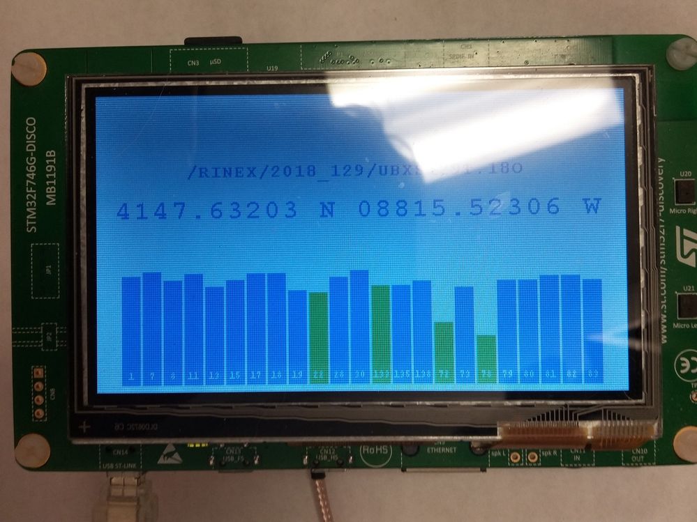

One of the pet projects is the CORS-LITE RINEX data logger, here running on STM32F746G-DISCO, where the expectation is the thing can run for hundreds of days without crashing, and a good way to stress code and hardware.
