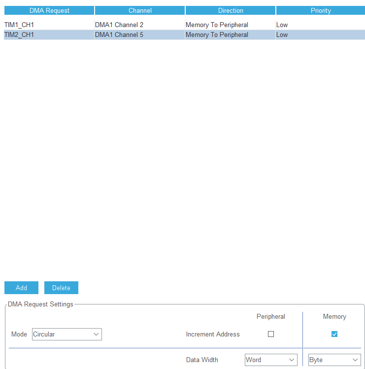

So I need a 800kHz PWM signal for some SK6812 LEDs, I already did achieve this with an STM32L433CCT on a custom board using this guide: https://www.thevfdcollective.com/blog/stm32-and-sk6812-rgbw-led
I set up my Project with CubeMX, the DMA setup there looked like this:

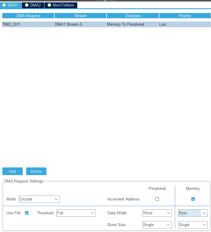

There the setup looked like this:

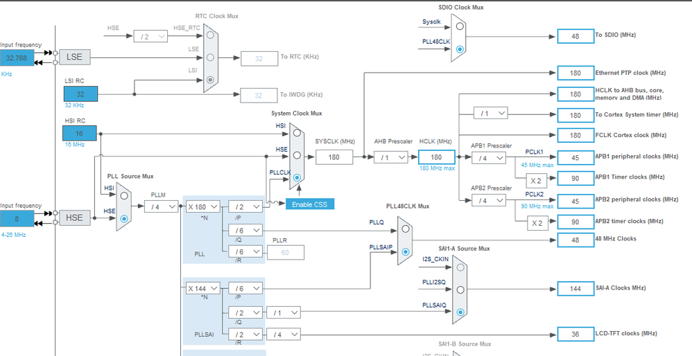

My clocks like this:
with a Timer period of 112-1 resulting in ~800kHz
I also tried it without FIFO, but then I am not able to select memorysize BYTE. It doesn´t really matter, it made almost no difference. To get to my Problem, when trying to output my PWM signal with this code from the guide above:

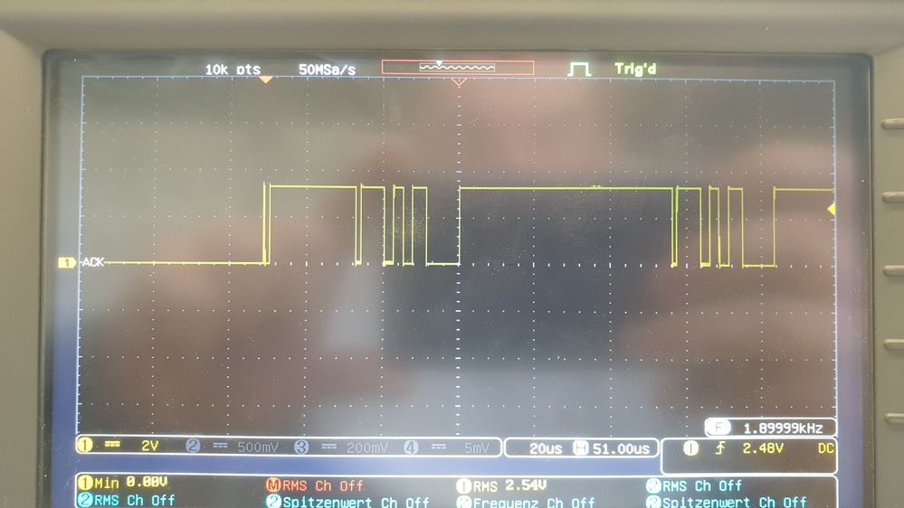

}I get this signal on an oscilloscope:

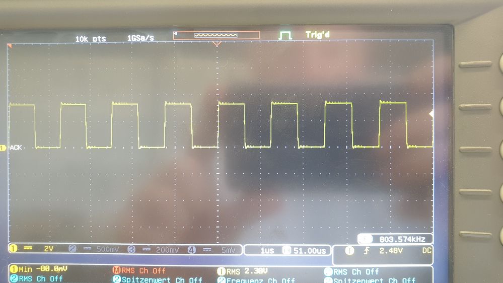

but when using this code to directly set dutycycle without DMA it looks different:
__HAL_TIM_SET_COMPARE(&htim2,TIM_CHANNEL_1,56);
HAL_TIM_PWM_Start(&htim2,TIM_CHANNEL_1);as you can see this results in the desired output signal. I am pretty sure this has something to either with my DMA setup or my approach on feeding the data to the DMA, yet I am not sure what the problem exactly ist. I tried it with FIFO an almost every burst/threshold combination there is yet it didn´t work. I also looked at the datasheet for the DMA without success though.

2021-01-07 3:21 AM
There are several differences between the single-port DMA in 'L4 and dual-port DMA in 'F4, but what affects you here is, that the single-port DMA, when set to byte on read side and word to write side, it zero-extends (pads) the byte into word; whereas the dual-port DMA won't (in particular, it will read 4 bytes on the read side and assemble them into a single word on the write side, if the FIFO is used; it will simply ignore the memory-side data setting if FIFO is not used, using the peripheral-side setting for both sides).
So, you have to do that "manually", by declaring the source array as words
uint32_t wr_buf2[WR_BUF_LEN2] = {0};
I don't use Cube/CubeMX, so I might've overlooked something else, too.
2021-01-07 3:21 AM
2021-01-07 4:16 AM
You dear sir are simply awesome!!!
That's it the whole deal, now it works again like a charm.
