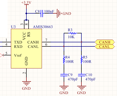

I'm so sorry. I did not explain it correctly. I've used the following circuit. Is this true? Could I connect these boards together with following circuit?

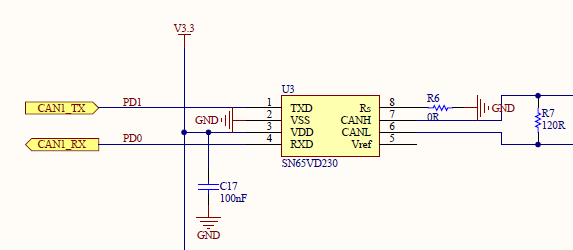

I don't recognise that way of connecting CAN. This is how I do it.
2014-06-12 1:44 PM
The diode trick was pretty clever.
