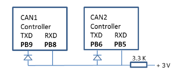

This works for testing purposes.It's from the keil example code, that I found a lot easier to get working and understand. (use 1N4148 diodes)
