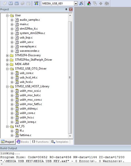

Perhaps you're not supposed to be using that file? Have you looked at the construction of any other of the projects for the supported tool chains? They are in ASCII, and human readable..
Perhaps you should be using STM32F4-Discovery_FW_V1.1.0\Libraries\STM32_USB_HOST_Library\Class\MSC\src\usbh_msc_fatfs.c ? and not diskio.c (a generic form)2014-08-24 2:09 AM

Odd then, that the project in Keil, using the correct files, compiles just fine....
Perhaps you should read my previous advice more slowly, instead of dumping all the files you can find into the project?2014-08-24 9:39 PM

This seems to involve a lot of work on my part to do your job. Attached is a dependency tree, in ASCII, parse it with AWK or PERL ________________ Attachments : Audio_playback_and_record_MEDIA_USB_KEY.dep : https://st--c.eu10.content.force.com/sfc/dist/version/download/?oid=00Db0000000YtG6&ids=0680X000006Hzjm&d=%2Fa%2F0X0000000bP2%2F6b.mL8dyasT5bRQv.KkDY1AFN.HPM5O4wdFQsmg16s8&asPdf=false2014-08-26 12:06 AM

Stop using DISKIO.C isn't not part of the project, I told you this last week. The functions declared in diskio.H are implemented in another file.
