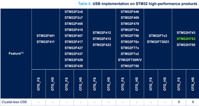

While I have you on here, can you please look at AN4879, and in Table 4, you'll see that STM32H753 line does not have the C or D checked. This is misleading as one of the main reasons why I bought STM32H753 is that it supports USB HS to support many audio channels. Can you confirm if that's a mistake?

About Table4, STM32H753 should have B and C checked. You can refer to Table 6. USB implementation on STM32 high-performance products, you can find both USB OTG controllers supported.
An internal ticket is submitted to dedicated team to update AN4879 table 4 (221053).
