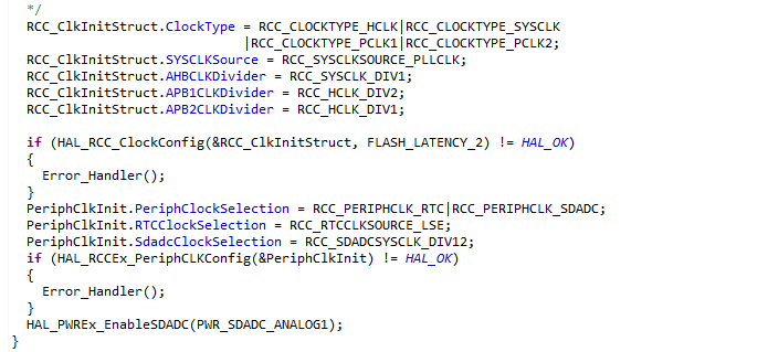

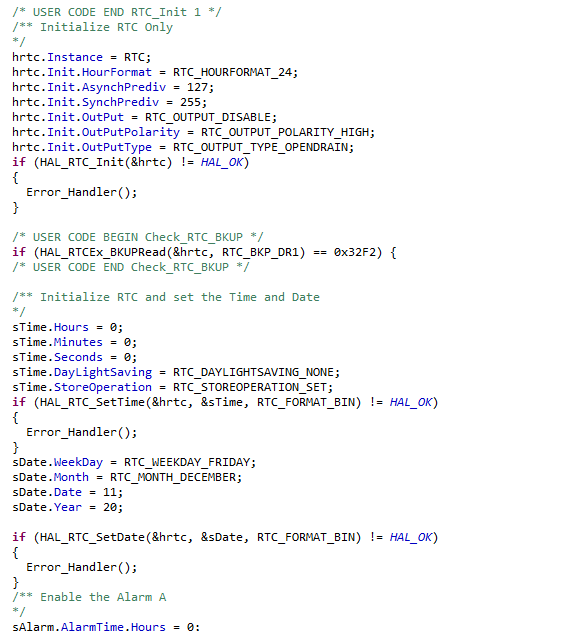

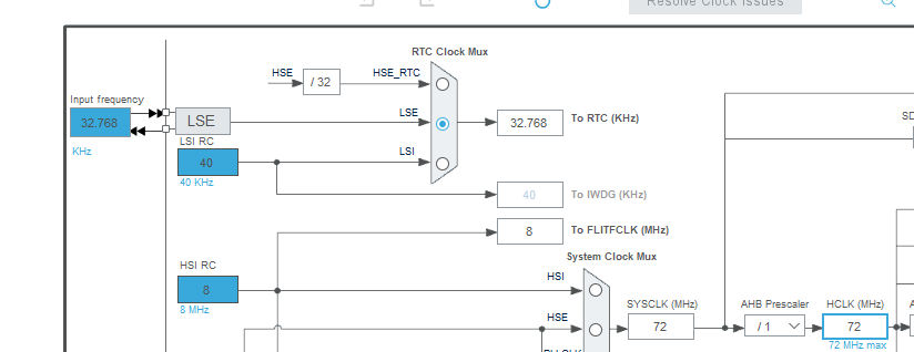

The RTC looses 15 min every 8 hour aprox when the main power is on. I have selected the LSE as the RTC clock, as i show in the images, and i have a 32.768 Khz 10 ppm crystal with a 9 pF load. I thought that maybe it was due to a bad match of the crystal capacitors but the RTC works fine when the main power is off! I really dont know what is going on... Thanks in advance.

Do you switch off/on or reset in any other way the 'F373 often?
The Hal RTC init sets the INIT bit in RTC, which causesthe subseconds to be cleared. The net effect is, that each reset results in average in half a second to be "lost". Search here on the forum, this is a recurring theme.

In the program i call HAL_RTC_GetTime and HAL_RTC_GetDate several times per second, in order to refresh the date and time of the system. I have tried to user this functions only when i press a button and it seems that doing this the system does not loose time. Could this be the problem? In that case how could i refresh the date and time continuously?
2021-05-28 9:19 AM
> I have tried to use this functions only when i press a button and it seems that doing this the system does not loose time.
These functions alone shouldn't do anything harmful. You ought to read date always after reading time, though, unless you have BYPSHD set.
