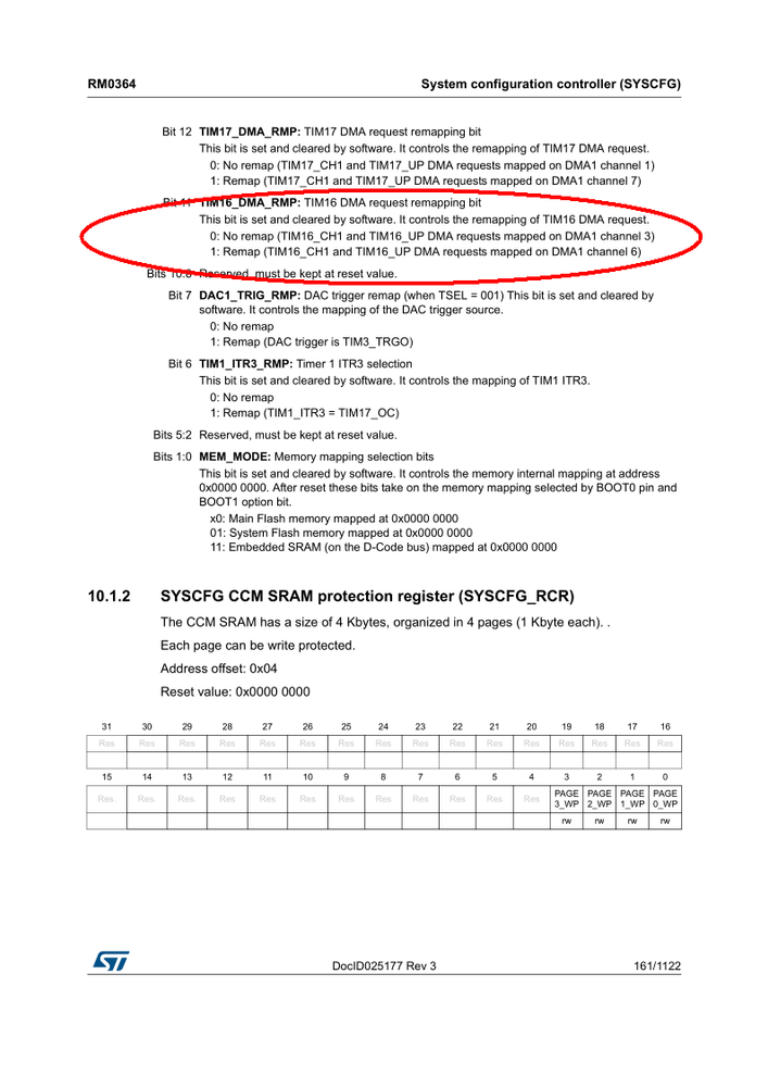

I tried the hole day to use two DMA channels (TIM16) as depicted in the
reference manual. If I understand it right, there is the option to use channel
3 and channel 6. At channel 6 the update event can be disabled. That’s exactly
what I need, both channels in parallel, one at update and ch1 compare and the second only
at ch1 compare.
I configure timer 16 and both DMA channels but only channel 3 works. I notice, that the ISR flags of channel 3 are set as expected, the compare output works but there is no channel 6 DMA transfer.
I tried to generate a sample code using Cube, but there on only the option to use DMA channel 3 or 6.
Does anybody know if I’m on the wrong track and it’s not possible to use both channels in parallel?
Thank you for your support.
Regards,
2020-05-20 1:12 PM
You can't have both, as there's a switch steering, which one.
2020-05-20 2:41 PM
Thank you very much. That was exactly my understanding and I tried that switch in the debugger as well. If I set it, channel 6 works but only triggered by the update, not CH1. Can you confirm that both DMA channels (3 and 6) will work together and in parallel, channel 3 at CH1 and UP and channel 6 only at CH1 (if mentioned flag is not set)?
It's strange and it looks like I have forgotten activating the CH1 DMA. But if I switch it off, the behavior of channel 3 will change so it looks like activation was successful. On the other hand, routing timer channel 1 to an output works fine.
2020-05-21 1:48 AM
That's surprising and not what the RM appears to say. I'd expect, both will work out of CH6 if the switch is set.
I don't have a 'F334 and would not try myself anyway, but I don't understand your point. Two DMA channels almost certainly won't work out of the same signal.
