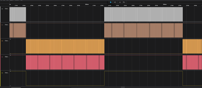

I have a digital power converter topology (H-bridge) which requires waveform to look like the following:
As can be seen in the above, complementary waveform is being sent on bottom 2 channel in 1st 10ms and then they are being in the IDLE state while complementary waveform is being sent on other 2 channels in next 10ms.

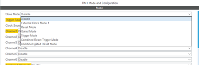

Hello TDK
do u mean to use TIM1 in gated mode?
2025-05-31 3:45 AM
You need multiple timers. Look at "Slave mode: Gated mode" in the reference manual.
Say TIM1 is the master, set TRGO and TRGO2 to drive TIM2 and TIM3 which generate the smaller pulses.
