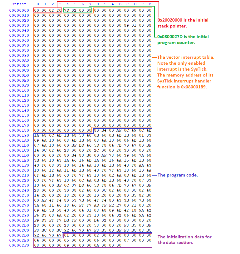

Reference :
http://tmdarwen.com/blog/in-depth-analysis-of-an-arm-cortex-m4-program
But , when i look at my bin file, the format seemed right till the vectors table. However, program code and data section wern't the same way as in the above reference.

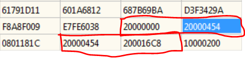

This is a snap shot of my binary - Address of data section : 20000000, 20000454, 200016C8 - these wernt exactly at the end of my bin file.
What i'm trying to accomplish is - decoding a bin file and how all the relevant info is structured in it. How to locate vectors, data section and program code in my binary file.
Thanks for your prompt replies. Would really appreciate your support on this.

Which also tells you:
The Map File
When building the project, we've specified in the
https://github.com/tmdarwen/STM32/blob/master/STM32F411/ArmCortexM4Analysis/Makefile
that a map file (out.map) should be generated during the linking step. The map file can be viewed with a text editor and is helpful to understand and confirm some of the conclusions we've come to when analyzing the bin file.2018-03-12 3:53 PM
Provide the .BIN, .MAP and whatever supporting material you have, it is hard to make sense of what is going on based on your description.
What does the table you're enumerating describe? Could it be pointers to other things in RAM?
Memory does not require that the 'Content' be in any specific order. What you are showing is the content without an address context.
