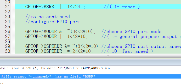

when I use GPIOx_BSRR to contral I/O port, it hint me ''error: #136: struct ''<unnamed>'' has no field ''BSRR'',why?
can you help me?
what is the meaning?

That's not a 'hint' - that's a full-blown error!
Look at your definition of GPIOF - is it properly defined as a struct? Does that struct actually contain a BSRR field?
Does your chip hardware actually have BSRR?
2018-03-12 10:23 AM
Right Click on the MODER and go to the definition of the structure. Likely you have a BSRRL and BSRRH, split as two 16-bit words.
If so use a cast to do a 32-bit write
*((uint32_t *)&GPIOF->BSRRL) = 1 << 24;

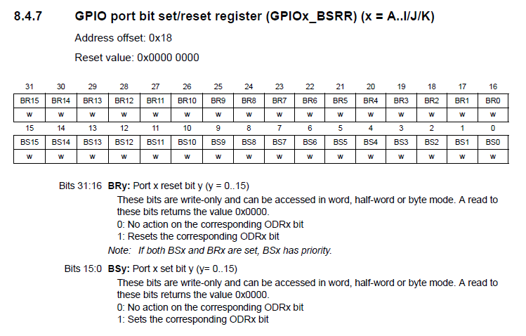

yes, my chip is stm32f407. According to the official refrence ,
''BSRR'' should be part of GPIO structure. But why is there no field space?
should not it be same as MODER or OTYPER?
2018-03-12 7:08 PM
Be specific about what library or include file is being pulled in.
Review the GPIO structure being used in this instance, then you'd know what it is looking for, and what exactly is implemented, and how.

yes, my chip is stm32f407. It did have two 16-bit words, BRy and BSy.
But the method you gave me I can not understand now. I will learn it. thanks a lot.
