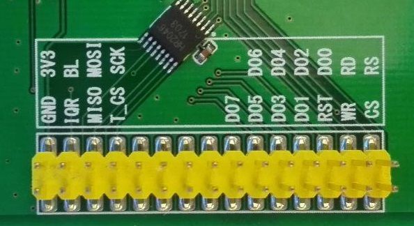

These are some of the LCD descriptions that I have.I'm going to write the code with stm32f217zg.
2018-03-05 9:51 AM
So and 8-bit FSMC interface to the controller via a 30-pin header

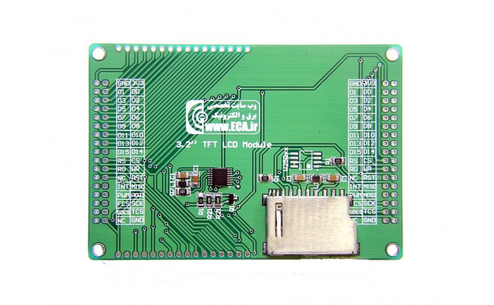

Bad news,i haven't ever work with FSMC.Does it have any pins on the tft?
And i found another tft library that is a little diffrent in some pins.Can i port its library?
2018-03-05 1:40 PM
Ok, and that looks to have a 16-bit wide bus.
The FSMC is the external memory interface of the STM32, much like the address/data buses of early generation micro-controllers, and decoded within the STM32 address space.
The questions I asked earlier will be true of other displays you find, pictures while interesting don't really go far toward actual documentation for boards and chips.
