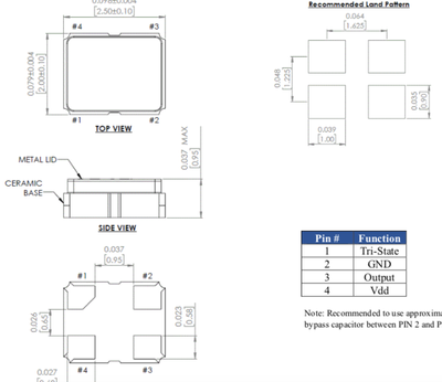

Your HSE Bypass configuration is correct.
