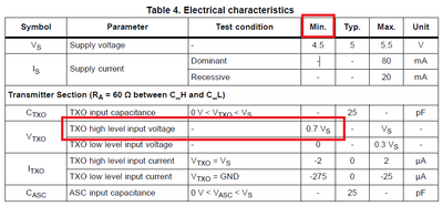

Besides that, I see another issue with the transceiver L9616 which is a 5V transceiver.
According to its datasheet VTXO min is 0.7 x Vs. In your case Vs = 5V -> So VTXO min = 0.7 x 5 = 3.5V that needs to be seen from the STM32. In your case, the latter is supplied by 3.3V and the GPIOs cannot deliver more than VDD = 3.3V. So it's out of spec of the transceiver. You need to supply your transceiver with maximum 4.71V (3.3/0.7) to be in the transceiver's spec.

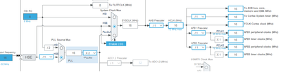

Could you please share your system clock config?

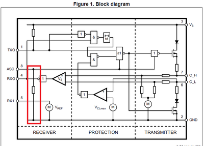

Regarding ASC pin and according to L9616 datasheet, the pin is pulled down to GND through an internal resistor:
I think no need to connect it for the moment. In this configuration you are in High speed config > 250kb/s

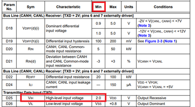

Regarding your last question about a transceiver replacement and since your HW is already fixed, I would suggest MCP2561 which is pin to pin compatible with L9616 (unfortunately there is no replacement from ST):
According to its datasheet this transceiver fit exactly your needs. Power supply = 5V and VIH min = 2V < 3.3V

This is my system clock configuration:
RCC_PeriphCLKInitTypeDef PeriphClkInit = {0};
RCC_OscInitStruct.HSEState = RCC_HSE_BYPASS;
RCC_OscInitStruct.HSIState = RCC_HSI_ON;
RCC_ClkInitStruct.SYSCLKSource = RCC_SYSCLKSOURCE_HSE;
RCC_ClkInitStruct.AHBCLKDivider = RCC_SYSCLK_DIV2;
RCC_ClkInitStruct.APB2CLKDivider = RCC_HCLK_DIV8;
PeriphClkInit.PeriphClockSelection = RCC_PERIPHCLK_USART2|RCC_PERIPHCLK_TIM1
|RCC_PERIPHCLK_TIM8;
PeriphClkInit.Usart2ClockSelection = RCC_USART2CLKSOURCE_PCLK1;
PeriphClkInit.Tim1ClockSelection = RCC_TIM1CLK_HCLK;
PeriphClkInit.Tim8ClockSelection = RCC_TIM8CLK_HCLK;
HAL_RCC_EnableCSS();

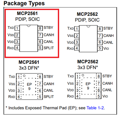

Hello, @mƎALLEm. I'm writing to tell you that I have just ordered a few MCP2561. Thanks a lot for your suggestion.

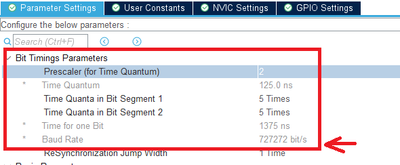

Hello again,
I tried to simulate your config and found that you have a non-common CAN bitrate:
This is your system clock config:
Could you please confirm?
Regarding MCP2561 has STBY pin which consists of putting the transceiver in standby mode. In that case you couldn't transmit/receive any CAN frame. There is an internal pull up resistor connected to that pin (by default standby mode activated). So you need to at least pull STBY pin to the ground.
