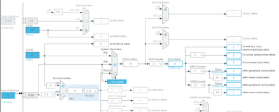

This is my system clock configuration:

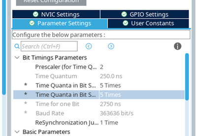

And these are the CAN settings:
They are different from yours.

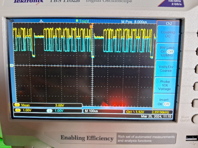

I took a picture of the scope:

2024-03-25 9:35 AM - edited 2024-03-25 9:43 AM
It's better to run at higher system frequencies for optimal function and keep some divider between AHB
I suggest the following system clock config if you don't have any power consumption constraints:
You configured the HSE in bypass mode. Is it intentional? Do you have an external crystal? or Crystal generator? you need to check.
But you didn't answer to my question yet regarding the strange CAN bitrate of 363636b/s. That's important!

I have an external 16MHz crystal. Maybe that is why the HSE bypass is configured. I sincerely cannot answer your question with certainty.
About the bitrate, how can I measure the real one? I thought the oscilloscope image would give some hint on that. With auto retransmission enabled, the scope shows a CAN frame with a payload of 8 bytes taking about 400us of the bus time. That gives me 2500 frames/s of 8 bytes each, or 160 000 bits/s. But I bet this is not the way the bitrate is measured. But by looking inside the frame, each bit seems to be using around 3 us of bus time, or around 333kbits/s. All these values are approximate as were measured on screen.

You need to get your CAN bus bitrate otherwise it couldn’t work. CAN bit time is strict it shouldn’t be calculated approximately, when it’s 500kb/s it should be 500kb/s no more nor less.

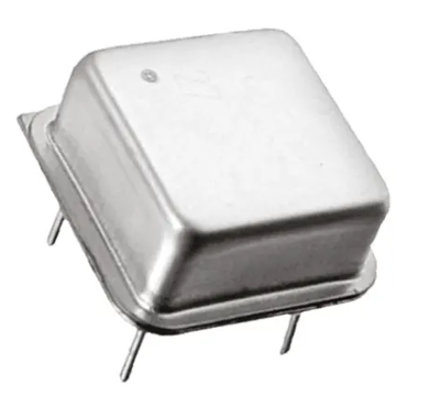

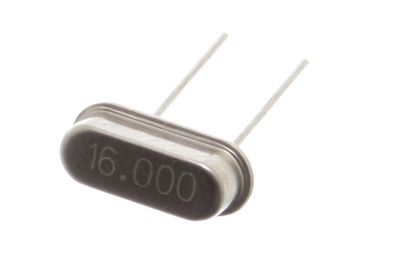

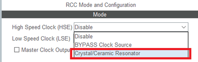

It depends on the external clock source.
If you are using this kind of crystal (through hole):
You need to configure HSE as following:
If you are using this one (through hole), you can keep it in bypass mode.
