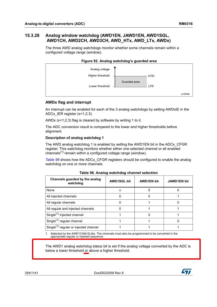

> By the way, you can also swap the thresholds of the analogue watchdog so that
> no interrupt is triggered when you leave the area, but when you enter it.
Are you sure?
My reading of RM is different:
According to this description, if you swap the thresholds, the status bit would be one all the time.
Jan
@peter BENSCH
2023-04-26 5:27 AM
@Community member Pretty sure. The RM0316 says:
The AWD1 analog watchdog status bit is set if the analog voltage converted by the ADC:
It does not say that the Higher Threshold HTx should have a larger value than the Lower Threshold LTx. So it should be possible to declare HTx smaller than LTx. Maybe not with CubeMX, but in the generated programme.
I had already had exactly this case with an older STM32, where an interrupt should be triggered when entering the area and not when leaving it - even if that was many years ago.
/Peter
2023-04-26 7:49 AM
@Peter BENSCH ,
I've just tried on an STM32F407, and it does not work in the way you've said - as soon as ADC_HTR<ADC_LTR, ADC_SR.AWD = 1 in all 3 bands (i.e. above LTR, below HTR, and in between).
Now my adage is that ADC is the most varying module across STM32 families, so this is not to say that it won't work in the way you've described on an 'F3 or on the older STM32 (was it an 'F1?).
Jan
2023-04-26 8:16 AM
@Community member Interesting, I had indeed done this with the F1, but had not yet tested it with the F3 and only extrapolated theoretically because the description is essentially identical. Thanks for checking, sorry to have raised false hopes. :|
/Peter
