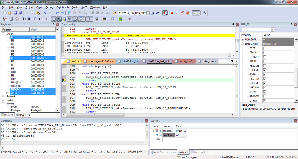

I'm trying make USB custom HID with stm32f302CB. I'm using Keil v5.23 and STM32CubeMX. The problem:

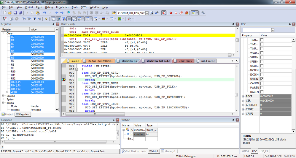

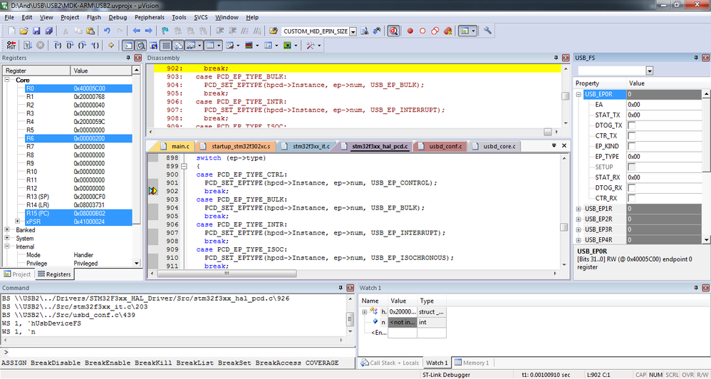

PC just don't recognize the USB, when i running in debug mode i saw something strange. Just after calling HAL_PCD_Init interrupt executing. In HAL_PCD_IRQHandler from there we go to HAL_PCD_ResetCallback. Thet calbek must config USB_EP0R register to config default endpoint. It perform by HAL_PCD_EP_Open. Ther are macros PCD_SET_EPTYPE thet write in USB_EPnR but in peripheral viewer they doesnt change. It's strange because others USB registers are writing normally. I'm trying write UART_EP0R by my own but it's doesn't work either. In RCC_APB1ENR USBEN is set.

2018-04-05 10:58 PM
Look into the RM - some bits in this registers are rc_w0, which means you cannot write them to 1; others are t, which means that writing 0 has no effect and writing 1 toggles its value.
Your problem will be most probably somewhere else.
2018-04-06 3:56 AM
Thanks for You'r advise but in reference manual in registers USB_EPnR are two rw bits EP TYPE that I traying to set, and it's doesnt work.
2018-04-07 8:43 AM
I know it's not in the RM, but I guess those bits are locked when the channel is enabled.
