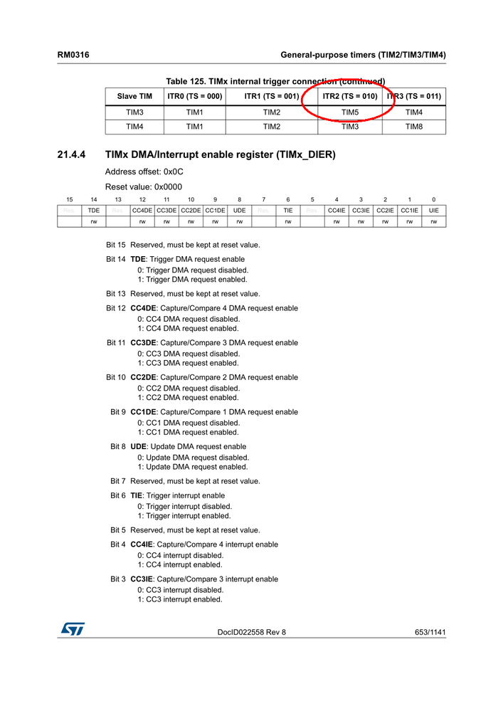

RM0316 says it's TIM5:
but there's no TIM5 in the 'F3 (except 'F373, to which RM0316 does not apply).
ST please clarify.
PS. Textual search finds TIM5 also in description of the TIMx_CCRx registers, obviously copy-paste relics.

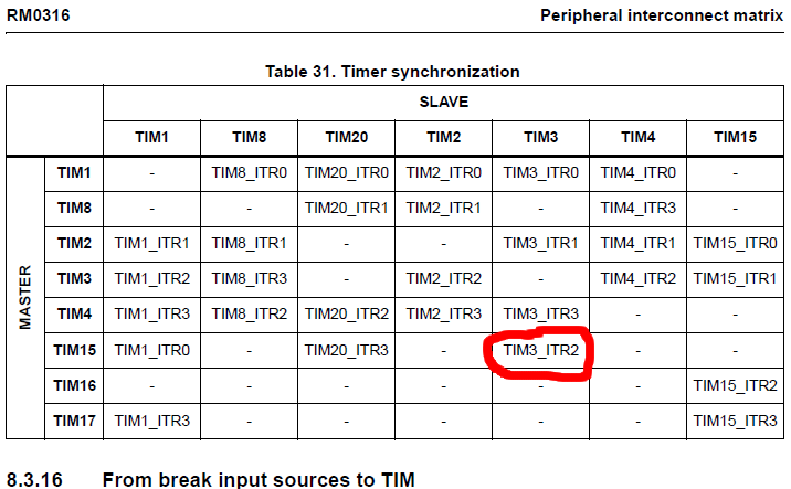

Confirming TIM15 to be ITR2 for TIM3 in STM32F303RB.
#define TIM_CR2_MMS__UPDATE 2 // update event -> TRGO
#define TIM_SMCR_SMS__EXT_CLK_1 7
#define TIM3_SMCR_TS__TIM15 2
RCC->APB1ENR |= 0
OR RCC_APB1ENR_TIM3EN
RCC->APB2ENR |= 0
OR RCC_APB2ENR_TIM15EN
TIM15->ARR = 1000 - 1;
TIM15->CR2 = 0
OR (TIM_CR2_MMS__UPDATE * TIM_CR2_MMS_0) // set update event as TRGO
TIM15->CR1 = 0
OR ( 1 * TIM_CR1_CEN ) /* Counter enable */
TIM3->SMCR = 0
OR (TIM3_SMCR_TS__TIM15 * TIM_SMCR_TS_0 )
OR (TIM_SMCR_SMS__EXT_CLK_1 * TIM_SMCR_SMS_0 ) // external clock mode 1
TIM3->CR1 = 0
;results in TIM3_CNT running.
Still would like to see this being fixed in both the RM, and AN4651. @Imen DAHMEN can you please have a look at this? Thanks.
2020-01-21 6:16 AM
Looks like a typo, it should be TIM15

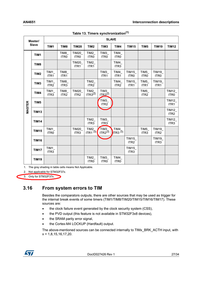

Meantime, more of this in the dedicated 'F3 "interconnections" appnote:
That whole table is of course a disaster - the 'F373 matrix is quite different and should've been taken out to a different table.
The tables in RM0316 should also account - at least in a footnote - for the unavailability of certain timers in certain models, e.g. TIM20 is available only in 'F303xD/E, TIM4 and TIM8 are not available
in 'F303x6/8 etc.

2020-01-22 1:31 AM
Thank you for highlighting this issue. I will check and raise this internally to fix all impacted documentations.
Note that the correction is already integrated in the next release of RM0351 (Rev 7) as reported in this discussion: https://community.st.com/s/question/0D50X00009sWbv9SAC/masterslave-problem-on-tim3-in-stm32l476-slave-not-counting-when-itr2-selected.
Best Regards,
Imen
2020-01-22 3:04 AM
Thanks, Imen.
Please note that this time it's the 'F3 (thus RM0316) not 'L4; I just mentioned the 'L4 thread because it's quite strangely the same error even if it is a completely different family.
Jan
