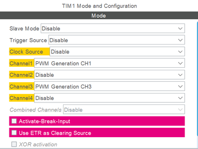

Can you please explain the TIM1 configuration in your .ioc file?
Your output signal should be configured in PWM input mode to be able to capture both the period and the duty cycle of the incoming PWM signal (TIM3)
