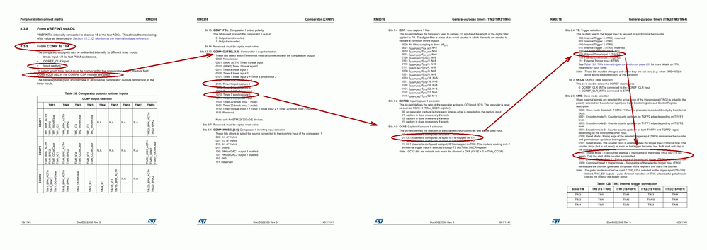

I am enabling timer at comparators interrupt but i am having some timing issues. I think it can solve this timing issues if I can enable the timer as hardware. In reference manual i couldn't find any way for do that.
Is there any way to do that ?
Thanks for any answers.
