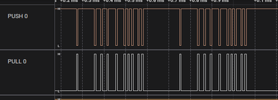

2024-09-13 10:41 AM
BTW, yes, I have configured both GPIO to the correct configuration, and yes, I have gotten it to work with the hack of restarting the TIM once via the normal mode and the next time with the DMA function, but I wish to do it by configuring from the beginning or something like that
Here a picture of what I am trying to achieve:
