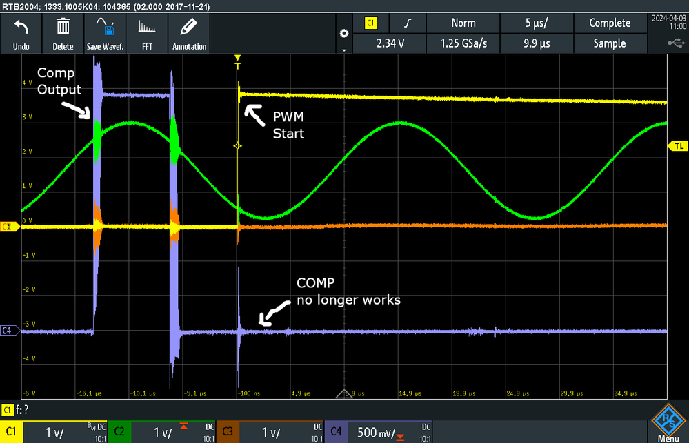

2024-04-03 2:15 AM
I add an osciloscope image to better explain the text above

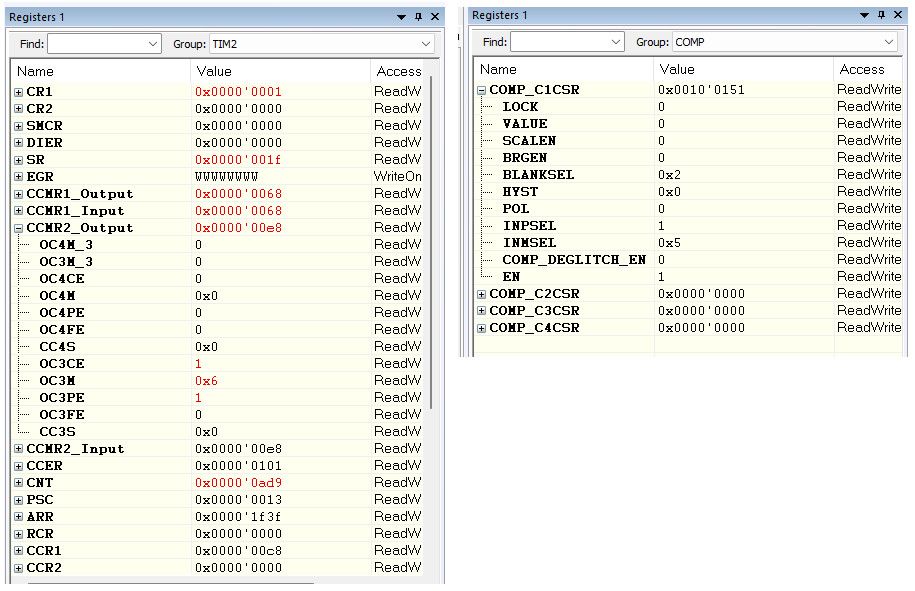

I also attach the TIMER and COMP register, they seem to be configured well:
I'm starting to suspect a bug in the hardware design of the STM32G431 ?
