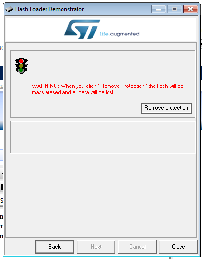

Flash Loader Demonstration error on (stm32f407 discovery board)
sir i used PB10 and PB11 as serial communication(USART 3) and connect BOOT 0 pin with VDD and PB2(boot 1) to GND. But its not working and there is a error............... and also click on Remove protection but warning is still not removed . plz help.............2015-01-17 5:35 AM
Flash Loader Demonstration error on (stm32f407 discovery board) sir i used PB10 and PB11 as serial communication(USART 3) and connect BOOT 0 pin with VDD and PB2(boot 1) to GND. But its not working and there is a error...............
plz help............. And did you read any of the suggestions in the thread before posting against it? Try connecting manually and report results. Try using a PC with a built in serial port. Try using 9600 8E1 (EVEN PARITY). Try explain how the serial circuit is wired (STM32F4 to PC)
