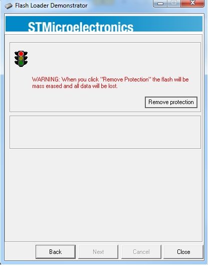

yeah my bad. I mixed the rx & tx pin's of the USART'1. But still can't to make flash loader work. Normally(as i've seen on youtube or read tutorials) after u press reset and select in flash demonstrator program port, baud rate, and even parity, u can click next , and the green light should light up flash loader should connect to stm32. However, i get a red light and it says: Warning, then u click ''Remove protection'' button, the flash will be mass erased and all data will be lost. I have never seen that on any tutorials or documents which i was reading, so any ideas why this happens? thanks.

Well, i've been struggling for a few days now, and here is what i can say: STM32F1 discovery board that i got works well. I send 0x7F to the bootloader and recieve 0x79. I can whrite to the flash memory of this board with no problems using STMFlashloader program. STM32F4 discovery board that i have also works, i can whrite to the flash memory of this board also with the flashloader program.(Only dont kno'w why, but through USART'1 i can communicate with bootloader only with very small baud rates < 4800. Any idea's why?) , and when it comes to F3 discovery board, i get this:

As for F4 discovery board, i meant to say it only worked for me with baud rates lower than 4800. I mean i only got it to work on 2400 or less. But here is the thing that really confused me now. I re-installed the Flashloader tool and for the first time, it allowed me to connect to the controller and program it's flash memory. When i'm done and quit the flash GUI and enter it again, it gives a warning (the picture in above post) and i can't get any further. The same happens with 2.5 and 2.4 version of the tool, after i install it for the first time, i can do everything right, after one time it gives a warning (the picture in above post), so i'm thinking now maybe its not GUI protocol level issues? Maybe processor lock's somehow his flash memory after it is programmed? Do you have any idea's abut this Clive? Or am i talking complete nonsense here? As always - thanks for your help and comments.

The auto-bauding is a one shot deal, so the main method to remedy things is to reset the board and try to reconnect. USB-to-RS232 serial dongles are sometimes more problematic than on-board serial ports. Without seeing what transactions are going on it's hard to diagnose, but generally communication failures tend to come up as complaints about option bytes, or protection settings.We’re moving the ST Community to a new platform to give you a better and more reliable community experience.
