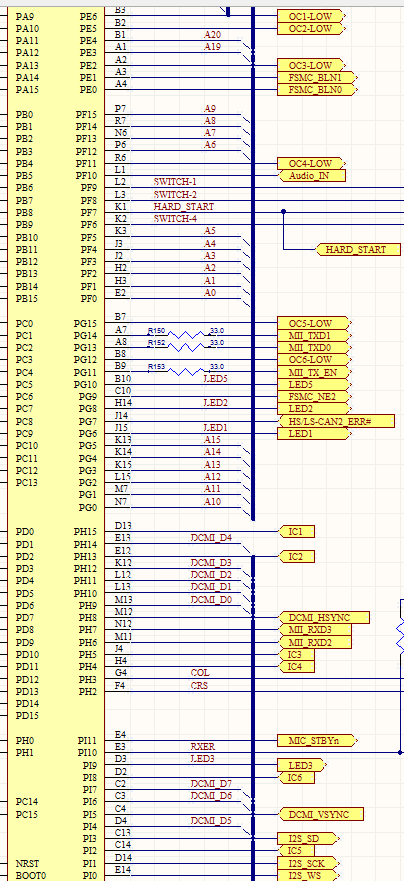

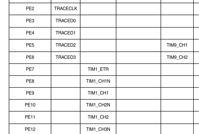

I'm not sure how to remap pins that do not line up correctly with the alternate functions specified in the datasheet. For example, the picture below shows the pin out of my microcontroller where OCx-LOW are pwm out and ICx are pwm in. Comparing it to the datasheet's alternate function listing, only some pins line up to timer channels. For example, OC1-LOW and OC2-LOW pin's alternate functions match up to timer 9 channel 2 and 1, but OC3-LOW and OC4-LOW don't match up to any timers on their alternate functions so I'm not sure how to use these pins with the timers for pwm out/in.
When they match, you can do something like the following, but not sure what to do when they don't line up.GPIO_InitStructure.GPIO_Pin = GPIO_Pin_2;

I guess you ask the board designer and review team what they were thinking? The AF muxing fabric has limited connectivity, it does not offer a crossbar-switch type functionality. So if it's not listed, it's not escaping on those pins. See if you have other free pins in your design where you can escape the signals you need, and add some trace wires to your board. TIM9 only has TWO channels. The other alternative is to program them as GPIO pins and drive them via software, providing the speed and placement are less critical.
