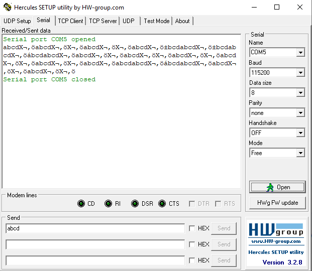

I have implemented an emulated UART on STM32F2 using the sample program from STM32F4. The UART TX data output is correct. Until a HAL_Delay(100) is add. When added delay, the UART TX output appears corrupted as shown below. Why is the HAL_Delay affecting the UART TX data? I have attached the whole project.

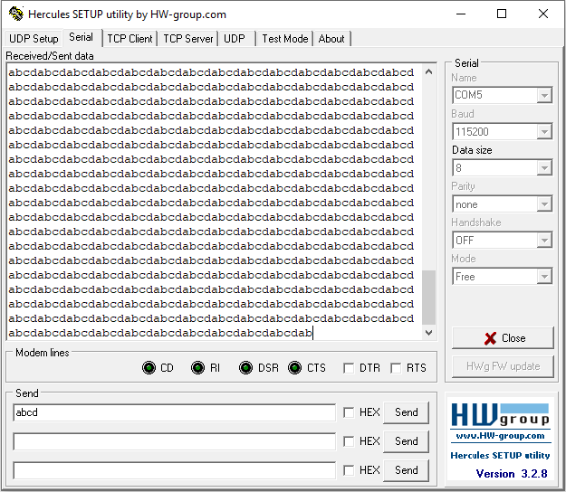

Hi just to add on, I am sending abcd in ascii and the HAL_Delay(100) caused weird ascii text to appear too. The data seems to be corrupted due to the delay. But if I remove the delay, the data is received correctly.
