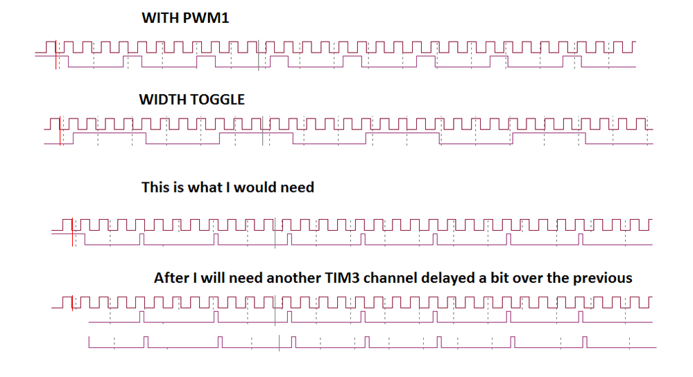

To start i'm using STM32F207I have a 15Mhz signal (that sometimes is enabled and sometimes it is not) connected to TIM3 ETR. I just want to count pulses and generate a pulse after few of this clocks (from 1 to 16 configured by software).To try it, I have set the TIM3 ETR (PD2 pin) as clock for TIMER 3, and it works (it starts counting). The code used is: RCC_AHB1PeriphClockCmd(RCC_AHB1Periph_GPIOD, ENABLE); RCC_APB1PeriphClockCmd(RCC_APB1Periph_TIM3, ENABLE); GPIO_InitStructure.GPIO_Pin = GPIO_Pin_2; GPIO_InitStructure.GPIO_Mode = GPIO_Mode_AF; GPIO_InitStructure.GPIO_Speed = GPIO_Speed_100MHz; GPIO_InitStructure.GPIO_OType = GPIO_OType_PP; GPIO_InitStructure.GPIO_PuPd = GPIO_PuPd_NOPULL; GPIO_Init(GPIOD, &GPIO_InitStructure); GPIO_PinAFConfig(GPIOD, GPIO_PinSource2, GPIO_AF_TIM3); TIM_SelectSlaveMode(TIM3, TIM_SlaveMode_External1); TIM_SelectInputTrigger(TIM3,TIM_TS_ETRF); TIM_ETRClockMode2Config(TIM3,TIM_ExtTRGPSC_OFF, TIM_ExtTRGPolarity_NonInverted, 0); TIM_TIxExternalClockConfig (TIM3, TIM_TIxExternalCLK1Source_TI2, TIM_ICPolarity_Falling, 0) ;This is working ok as I said. Now I want to make a pulse faster than TIM3 clock if possible. Configuring TIM3 to count up from 0 to the current count limit TIM_TimeBaseInitTypeDef TIM_TimeBaseStructure; TIM_TimeBaseStructure.TIM_ClockDivision = TIM_CKD_DIV1; TIM_TimeBaseStructure.TIM_CounterMode = TIM_CounterMode_Up; TIM_TimeBaseStructure.TIM_Period = 3; //Count limit TIM_TimeBaseStructure.TIM_Prescaler = 0; TIM_TimeBaseInit(TIM3, &TIM_TimeBaseStructure); And now I have to set the output. I would like a pulse, so i tried the One-Pulse thing, but it is not working or not working as I wished. I have tried with PWM1/2 and Toggle. It counts right, but toggle is not ok since it generates a ''clock divider'', and pwm generates pulses at speed of the clock and thats not ok.I would need a small delay between the detection of the counting event and the rising of the output. This is what i tried: TIM_OCInitTypeDef TIM3_OC; TIM3_OC.TIM_OCMode = TIM_OCMode_PWM1; TIM3_OC.TIM_OutputState = TIM_OutputState_Enable; TIM3_OC.TIM_OCPolarity = TIM_OCPolarity_High; TIM3_OC.TIM_Pulse = 1; TIM_OC3Init(TIM3, &TIM3_OC); TIM_OC3PreloadConfig(TIM3, TIM_OCPreload_Enable); TIM_SelectOnePulseMode(TIM3,TIM_OPMode_Repetitive); TIM_SelectInputTrigger(TIM3, TIM_TS_TI2FP2);In the image attached I explain what to I get and what do I need. I have seen a card done by another company using STM32F207, and same pins (PD2 clk input, PC7 pulse output and PC8 pulse output). Any idea or help would be welcomed.Thanks in advance2015-02-27 5:06 AM

Given you want a smaller pulse width than the input clock, you're going to have use a master/slave relationship using TIM3 to trigger a one-shot mode on a different timer clocking at a higher rate (system).

Thanks for your answer clive.
