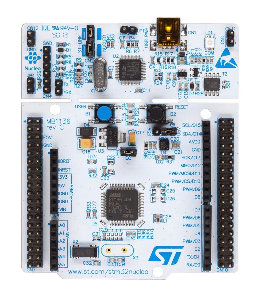

I have a stm32 nucleo-64 stm32f103 and i tried to use the swd port to connect to the target board via pin 1-6 and could not, is this the correct board do i need another one?

i can connect fine with my pe cyclone fx no errors i don't mind using the stlink i already have if i can get some help on how to set it up to read the target board via pin 1-6. i want to back up all the data on the f105 and put it on another mcu.

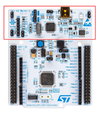

For the NUCLEO to connect to an external target you must pull the jumpers to disconnect the local target.

what pins do i remove to make it read external target?

Did you de-attach this part?
If not, connect a USB cable on CN1 and use CubeProgrammer to connect to the MCU.
