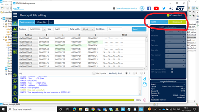

At first, I am able to Jump to internal bootloader while running the application code from SRAM and further able to connect STM programmer using UART interface. At this time the RDP flash protection was not enabled.

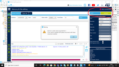

Now when RDP protection is enabled and I execute the same piece of code, I get the following warning.

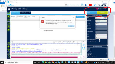

In this JumpToBootloader function, I am unlocking the flash and option byte and making the RDP level 0, it’s not jumping to the bootloader and then it’s showing the error: Activating device KO.
