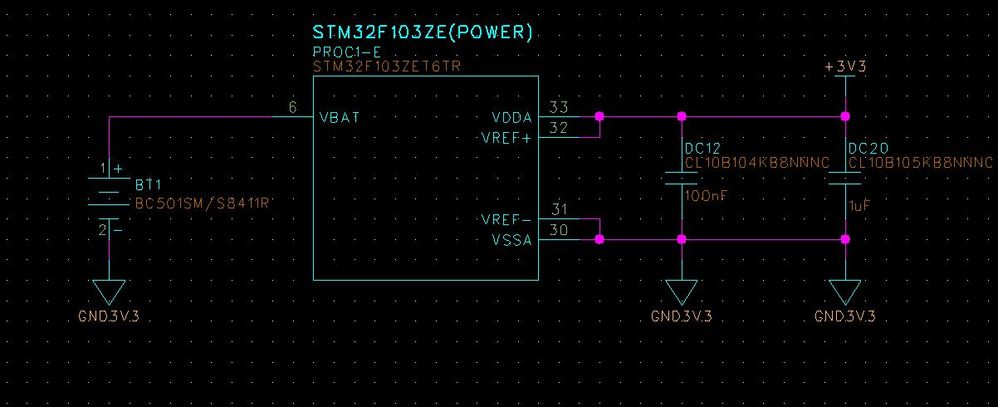

I have a question about RTC BATTERY BACK UP.
I am using RTC.
And an external battery.
When the power is ON / OFF, the RTC TIME backup function works well.
However, RTC_DATE is not backed up.How to solve the problem please let me know.
Below is the battery schematic and c source.
